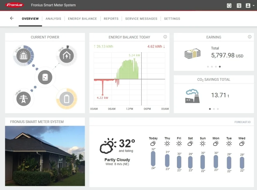

Monitoring Software and App
Fronius SolarWeb - online monitoring portal enables full site generation and consumption monitoring with the Fronius Smart Meter installed.
Wi-Fi monitoring comes standard with all inverters via the Fronius Solarweb. The addition of the Fronius Smart meter enables monitoring of energy generation and consumption and can be used as a complete home energy monitoring system. The Fronius Solarweb app is an easy-to-use app that displays solar generation, consumption and estimated savings. The analysis section offers detailed operating statistics like string current and grid voltage. However, the software capability is limited, and only three days of consumption monitoring data can be accessed without a premium subscription to the Fronius Solarweb.

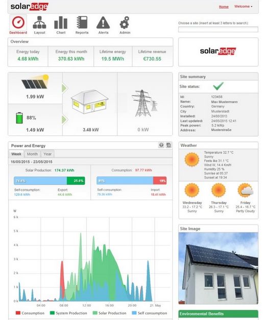

Solaredge DC Optimisers are small electronic modules attached to the rear side of each solar panel, enabling each panel to operate at its maximum power level. Note that panel-level optimisation is not unique to SolarEdge; similar benefits can be obtained through microinverters and add-on power optimisers such as those from Tigo Energy.
SolarEdge has one of the best smartphone apps for remote system monitoring. The MySolarEdge App is a free cloud-based system monitoring portal that provides solar generation and consumption monitoring (with an additional energy meter). It also provides detailed panel-level monitoring (once enabled), along with a suite of smart home control features that can be used to control home appliances and specified loads with the additional SolarEdge smart energy products, including the SolarEdge EV charger.
The MySolarEdge App is a great, easy-to-use for full system solar monitoring and home automation
