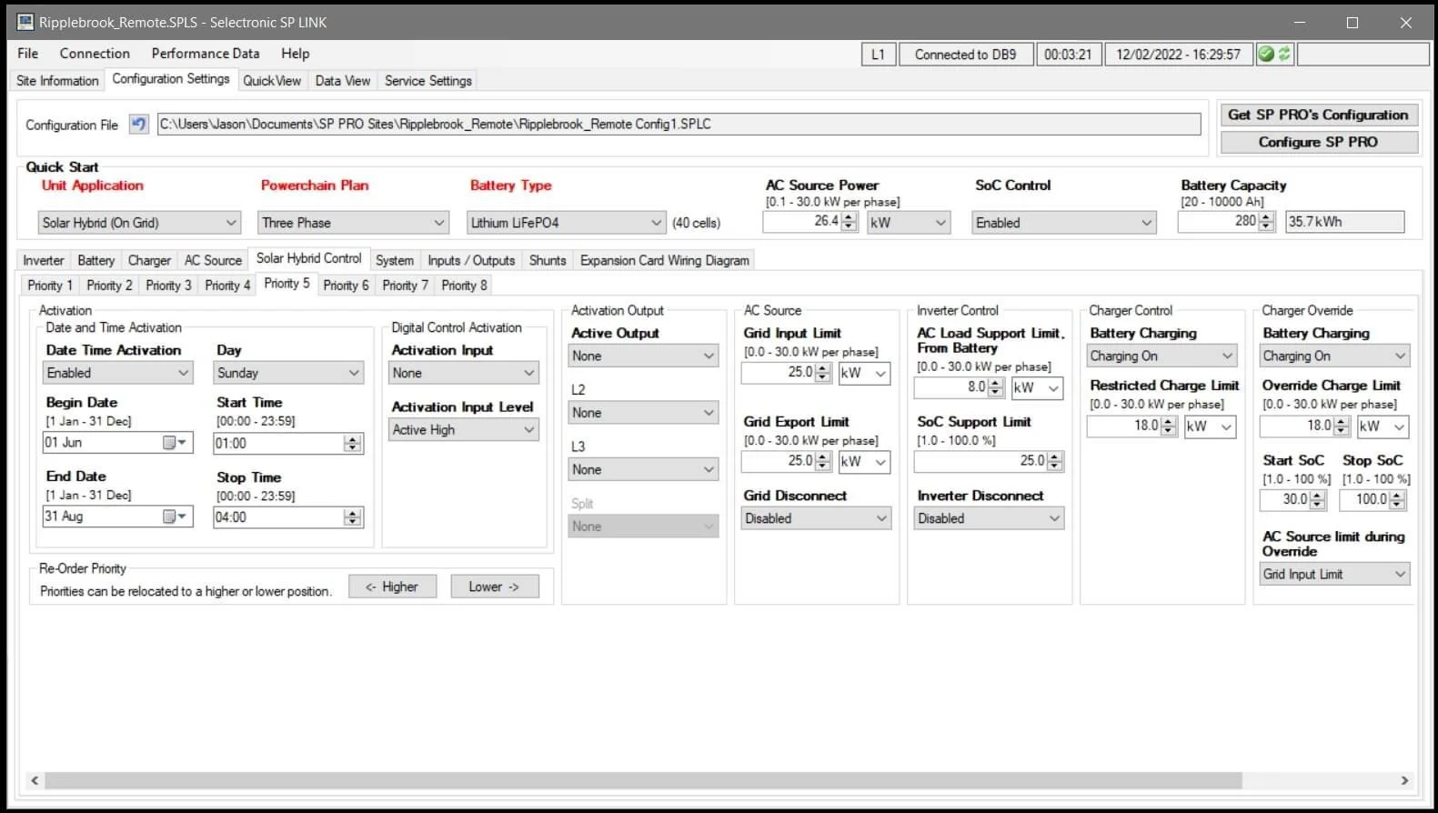

3. Inverter Charge Rating
The battery inverter's max charge rating, measured in Amps, needs to be considered to ensure the battery bank capacity and inverter are ‘balanced’ correctly. Ie. In AC-coupled systems, ensure the inverter-charger has enough charging capacity to enable the battery to reach the absorption charge voltage. If the battery bank is too large and the inverter's charge rating is too small, the battery will not complete a full charge cycle. This will result in unbalanced cells, poor performance, degradation and possible sulfation (if lead-acid batteries are used).
Most modern lithium battery systems can accept a high charge current and can be charged at a higher C rate. If an oversized solar array is used and the inverter charge rate is insufficient, the solar generation may be clipped (reduced), and the system will not perform as efficiently. DC-coupled solar can help overcome this issue as the solar array is directly connected to the battery system and not contained by the inverter's charge rating.
Selectronic Inverter spec sheet highlighting the maximum charge rating
Example: Selectronic Inverter spec sheet (SP PRO) highlighting the maximum charge rating in red.

SP PRO inverter advanced system control software
Selectronic SP.Link software is used to configure the SP PRO inverter-charger. This advanced software package has 8 system priority settings enabling multiple operating modes depending on the various inputs, outputs and battey SOC. Click to enlarge
