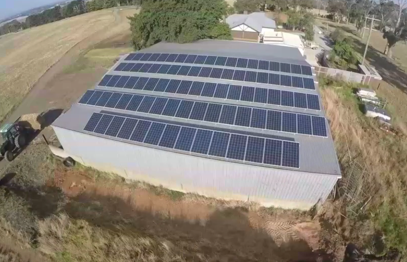

The 240 solar panels (60kW) is designed to do the bulk of the work while the three 1kW vertical axis wind turbines assist with the battery charging. The aluminium wind turbines were an experimental design but have unfortunately had some issues with structural fatigue at the welds. Luckily the solar is performing far beyond expectations with the afternoon milking cycle being directly powered by the 22.5kW west facing and 28kW of north facing solar panels. There are also 9.5kW of east facing panels to help capture the morning sun.

The 22.5kw of west facing panels on the hayshed
