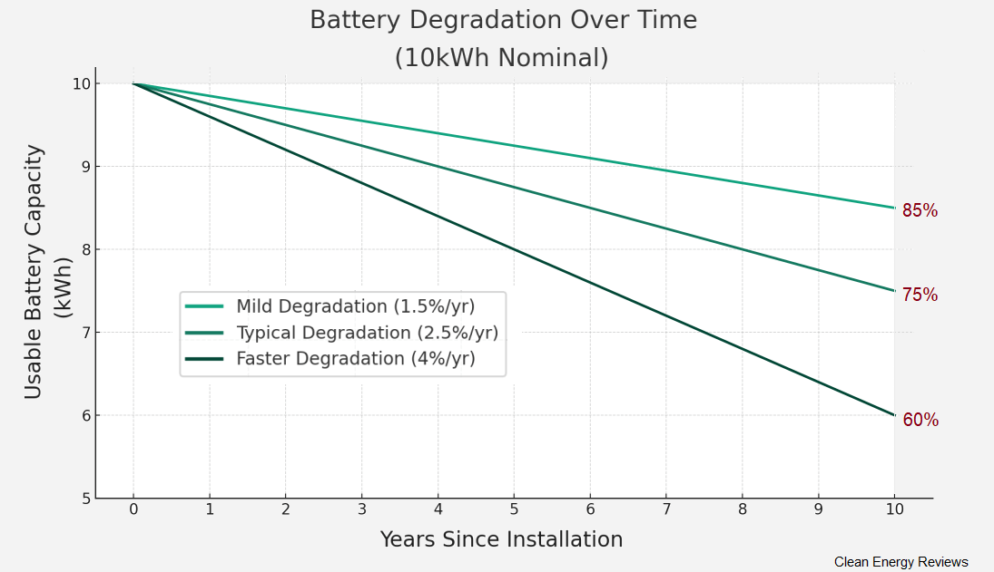

Battery Degradation Explained
All lithium-ion batteries degrade over time — this is an inherent chemical process that occurs with each charge and discharge cycle. Even with careful use and ideal conditions, the battery’s ability to store and deliver energy gradually decreases. Typical degradation rates vary depending on battery chemistry, temperature, usage patterns, and management systems. However, most high-quality lithium batteries (especially LFP-based systems) degrade at an average of:
  • 2% to 3% capacity loss per year, in a well-designed and moderately used system.
  • Some batteries may degrade 1.5% per year or less under light use or shallow cycling.
This natural loss of capacity is factored into the warranty, which is why manufacturers specify the minimum capacity at the end of the term, known as the End-of-Life (EOF). However, even if the battery has reached the end-of-life capacity as stated in the warranty, it does not mean the battery can no longer be used. As long as the battery is functional and operating without errors, technically, it can be used for many more years. Learn how you can increase the life of your lithium battery.
Battery capacity loss graph
