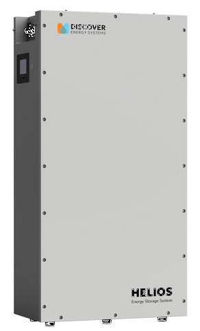

The HELIOS Energy Storage System (ESS) is a 16kWh heavy-duty, high-capacity, 48V all-in-one lithium battery designed for demanding residential and commercial energy storage applications. Built using large-format LFP cells, HELIOS ESS stands out in the market due to its high continuous power rating of 10 kW (with a peak of 19 kW for 10 seconds) and its robust steel enclosure, which includes an integrated heater as standard. This ensures reliable performance even in sub-zero conditions down to –25°C, making it suitable for alpine and off-grid environments. However, some internal insulation lining would help maintain a stable internal temperature.
HELIOS is engineered for scalability, supporting up to 36 units in parallel to deliver a total capacity of over 570 kWh. It features both open-loop capability and closed-loop communications for seamless integration with leading inverter brands, a 4th-generation high-current BMS, dual fire arrestors, and emergency shutdown. HELIOS is one of the more advanced plug-and-play outdoor battery systems available at a very reasonable price.
While it also features a small LCD on the left-hand side, the information displayed is very limited to battery voltage and current. Unfortunately, it does not provide battery SOC, fault codes or communication status information. For battery operating details, you will need to connect it to a laptop using a USB cable and the LYNK Access software.

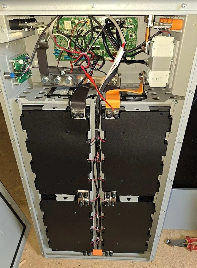

A look inside the Helios ESS battery with the cover removed.

  • Messy and unsecured internal cable routing.

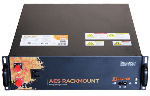

The AES Rackmount ESS is a modular, lithium battery system engineered for flexibility and high power delivery. Designed for installers, the AES Rackmount ESS is Discover’s rack-mount lithium battery platform, offering maximum flexibility and rapid deployment in both on- and off-grid systems. Each module provides 5.0 kWh of usable capacity and can be stacked to suit a variety of installations, from single-battery home systems to large-scale commercial systems.
What sets the AES Rackmount apart is its high continuous and peak power rating, with each module delivering up to 70A continuous and 95A peak output (1 hour), enabling high load support from a compact footprint. Plus an extreme 2.2C surge power rating providing a maximum of 218A for 3 seconds.
For colder climates, an optional integrated heater model ensures reliable charging and discharging in sub-zero temperatures. AES also features a fast installation design using the Discover Quick Stack rack and plug-and-play Amphenol connectors.

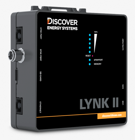

🔗 Discover LYNK II Communication Gateway
Discover Lynk II
The LYNK II Communication Gateway is a vital component in the Discover Energy Systems ecosystem. It provides seamless closed-loop (CANbus) communication between Discover lithium batteries and a wide range of hybrid inverters, charge controllers, and energy management systems. Without the LYNK II gateway, Discover batteries (excluding the Helios ESS) can only be used in an open-loop (self-managed) control, which can lead to inaccurate charging and reduced performance over the life of the battery. The addition of LYNK II ensures a fully intelligent and optimised energy storage system, plus remote battery monitoring via the LYNK Access software described later.

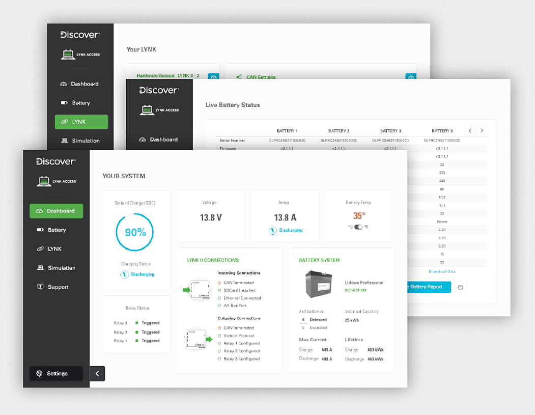

LYNK ACCESS Software
Lynk Access Software
Discover’s new LYNK ACCESS software significantly enhances the capabilities of the LYNK II Communication Gateway, making it one of the most advanced lithium battery integration and management tools currently available. Designed for installers and system integrators, LYNK ACCESS allows for complete device programming, remote system access, and advanced data analysis. This streamlined tool not only simplifies commissioning and speeds up integration with third-party hardware but also enables real-time monitoring, diagnostics, and fine-tuned charging control. With remote access capabilities, users can manage and troubleshoot systems remotely.

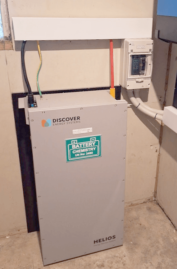

🔧 Personal Experience
Discover Helios ESS battery installed
I’ve been designing and installing off-grid and hybrid power systems using Discover AES batteries for several years, and more recently, the new Helios ESS battery system. Overall, I’ve been very impressed with the features and real-world performance.
One standout has been the compact, solid design of the Helios ESS. It’s robust and packed with features, including a built-in digital display, integrated heater, and the flexibility to operate as either a self-managed or fully managed battery via CANbus. This makes it especially useful for upgrading older off-grid solar systems that lack the communication options of modern inverters.
However, it’s not all good news. I have found it challenging to ensure the communications terminals on the top right side are protected from water and dust ingress. Due to the open, exposed section above the connection area, I would recommend avoiding outside installations unless they are installed with a protective cover. Another slight downside I have found is that the weight can make it very difficult to handle and install.
If you are on a budget, the Helios offers very good value for money. This battery is one of the most competitively priced 48V lithium battery systems from a top-tier manufacturer, offering high capacity, great features and high power. While it is still early days and long-term performance is still unknown,
